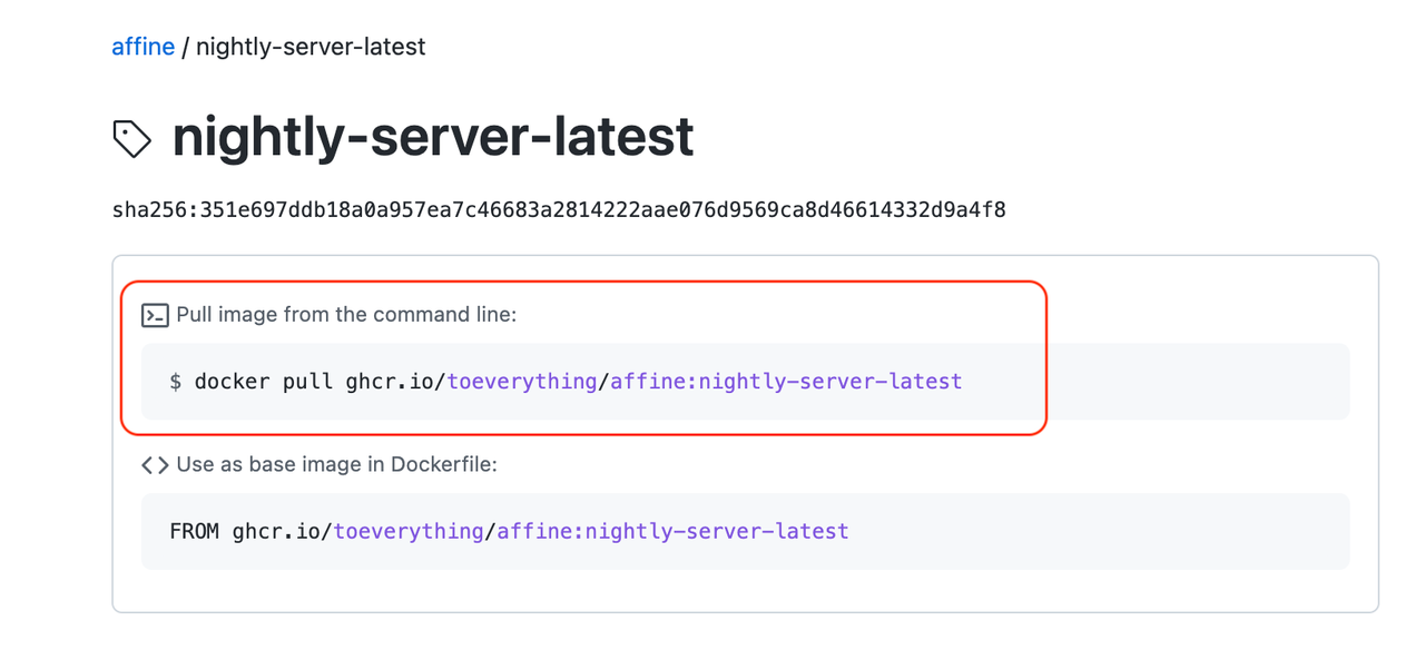

Step 1: You can find the docker command from our GitHub packages page - the latest release at the time of writing uses the tag nightly-server-latest. Please check the link above for the latest tags available. You can then pull the image, replacing the image name nightly-server-latest as necessary:
docker pull ghcr.io/toeverything/affine:nightly-server-latest

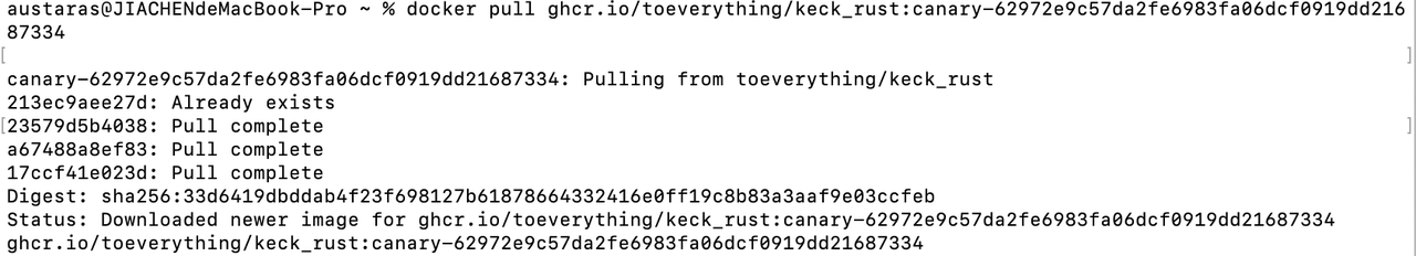

AAGnFROUfTlW9ehJDlqdrs-4S58SphIOX1Cfc3ae8jI=
You'll receive a similar message, which indicates that the latest Docker image has been downloaded.

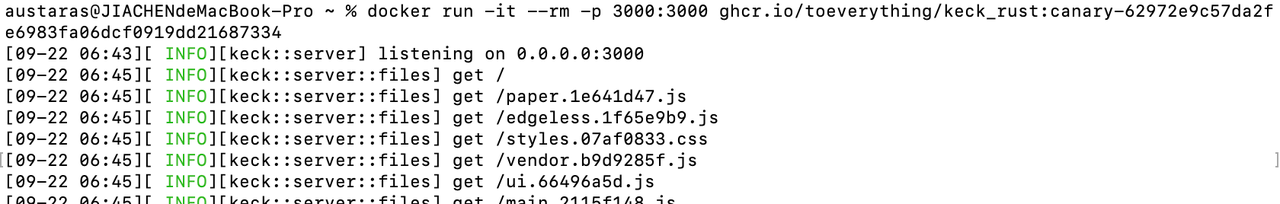

Step 2: After successfully updating the Docker image, we are now ready to run the docker run command.
docker run -it --rm -p 3000:3000 -v YOUR_PATH:/app/data ghcr.io/toeverything/affine:nightly-server-latest
Notes:
The command should take the following format docker run -it --rm -p -v YOUR_PATH:/app/data 3000:3000 [image id], where the image id should be the same as in the first step. You can also set [YOUR_PATH] to store the data on your host machine, outside of the Docker environment(Remember to replace [YOUR_PATH] with the real path on your local device.).
Alternatively, you can directly run the following command:
docker run -it --rm -p 3000:3000 ghcr.io/toeverything/affine:nightly-server-latest
If there are no issues, your AFFiNE deployment should be up and running, you'll receive a similar response as to the image below.

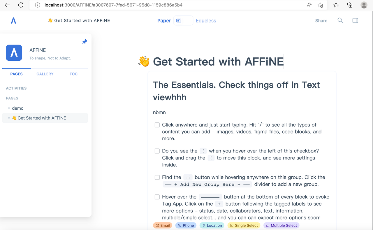

Step 3: Head over to your browser and visit localhost:3000 (if you are deploying locally, you'll need to enter the IP address if you've deployed it onto a remote server).
-DT3qk6WNVd73Sx_VT59LUv9O1UOJ4FHV-yQ951enB8=
At the time of writing this update, nightly-server-latest, provides you with a brand new Docker container. Docker is a lightweight virtualization platform based on Linux kernel isolation implementation. It allows us to provide you with a unified system environment, which ensures that you'll receive the same smooth feature-rich experience no matter which platform or operating system you deploy on.
With this update, the self-hosted version of the live demo will automatically synchronize data to the server and store it in the /app/data directory in the container.
